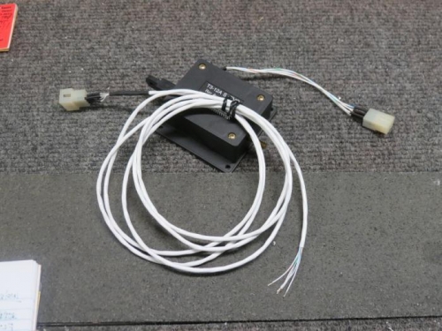

Brief Description:  Fabricated trim harnesses
I went to a local industrial surplus outlet this morning and scrounged a selection of small Molex wiring connectors made for small wire gauges. Using the Molex connectors and appropriate gauge wire I fabricated harnesses for attaching the roll servo and the pitch/roll LED indicators that will be part of the trim circuitry.

Aileron Trim Servo
Aileron Trim Servo
