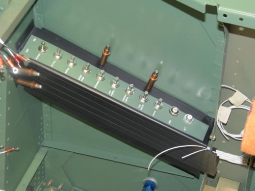

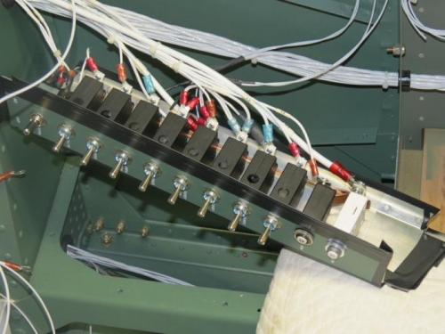

My earlier attempt at organizing and terminating the wires at the starboard switch/breaker console had to be reworked. The wiring got bulky and a bit inflexible at the nav and strobe connections. This is due to the heavier three conductor shielded cable. I reworked the terminations to eliminate as much as possible any need to bend any of the wires. I also installed some lead wires to ground the shielding and splice the strobe sync wires.
To avoid scratching the interior paint I covered the console temporarily with black electrical tape. When I am done with the wiring and work in this area the tape will be removed. Hopefully, this will keep the interior panels from getting too beat up.

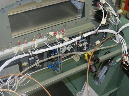

I also spent additional time today organizing the fuselage wiring. This consists of verifying the proper routing, cutting runs to final length, and terminating with the appropriate connectors.
Bottom of Console
Bottom of Console
Protective Tape
Protective Tape
Cleaning Up Rats Nest
