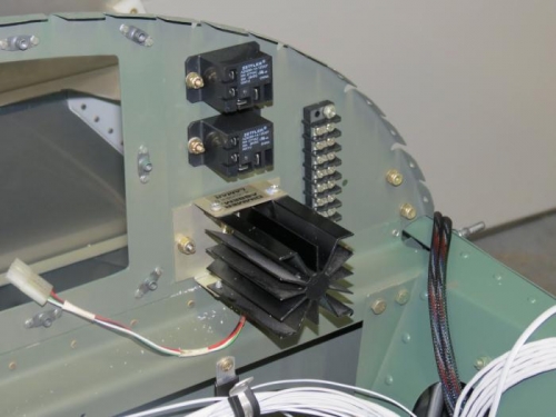

Seems each day I find more wiring that needs to be added. Today I installed two small 30Amp relays on the forward upper bulkhead to be used for controlling the boost pump and starter from the Infinity stick grips.Also snugged down all the fuse blocks and the encoder mounting plate. The two terminal strips (left and right) were also reinstalled.
I don't have any schematic for the boost pump and starter circuits using the relays so I will have to figure that out before installing the appropriate wiring.
More circuits were added including wires for the dual fuel gauges and the 12V power outlets for auxiliary equipment. Don't know yet where the forward outlet will be but the wire is there it just needs to be cut and terminated.
Boost & Starter Relays
