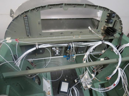

Worked on more miscellaneous items today, mostly wiring related. The two forward bulkhead panels that form the front baggage compartment were riveted in place and most of the components mounted to the panels were reinstalled.

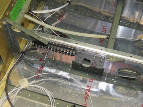

The ADI harness was secured with cushioned clamps and a 12 position terminal strip installed on the rib just aft of the pass-thru for the aileron tubes. This strip will be used for wiring the Infinity stick grips. A ground post was also installed in the rib.
Additional wiring was installed including the bundle that goes thru the starboard side of the firewall (magneto wires, etc.).
Forward Bulkhead Panels
Under the Floor
Under the Floor
