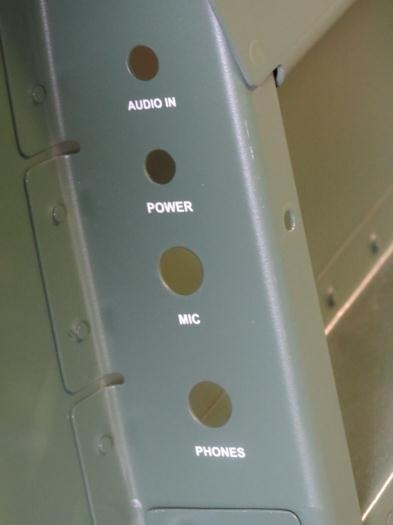

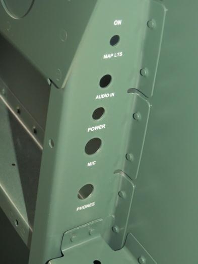

I applied the rub-on labels for the pilot and co-pilot positions this afternoon. I had to stand on my head to apply the labels and get the spacing correct. After the lables were positioned and burnished in place, I masked off the area around the bulkheads and sprayed some clear coat satin to protect the lettering.
To avoid the possibility of the clear coat wrinkling the green finish I placed a fan on the painted surface to dry the solvent-based clear very quickly. I think it looks nice, just hope it holds up to the inevitable wear.
Starboard Bulkhead (Pilot)
Starboard Bulkhead (Rear)
