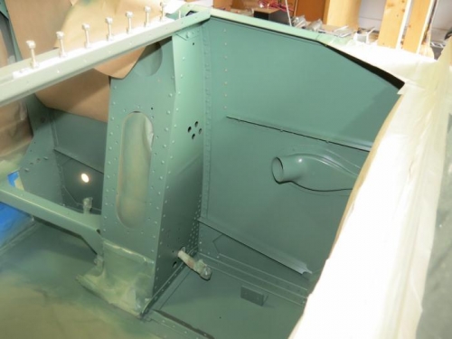

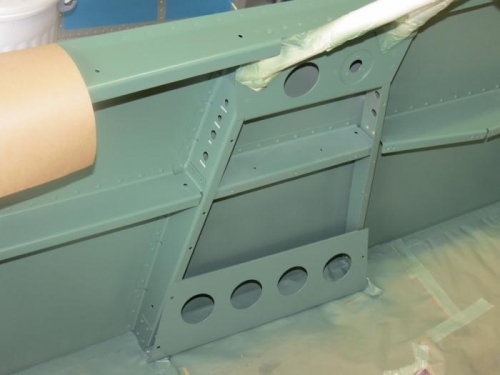

Brief Description:  More fuselage painting
Finally got the first coat of color on the forward fuselage interior. It's not perfect but it should be ok, especially after all the interior panels and components are added. It is really hard painting the interior of the fuselage with all the nooks and crannies. To get a smooth finish you have to keep the paint nozzle fairly "square" to the surface and a uniform distance. Once the trigger is squeezed the whole space fogs up with spray making it hard to see. Glad it's almost finished!
Image 1 below shows one of the "improved" compartment panels I modified a few days ago. It will eventually be attached to the bulkheads with three pan head screws.
