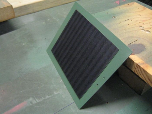

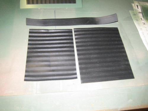

Brief Description:  Testing of vinyl floor material - 2
The first photo below shows the vinyl after exposure to the fluids (no noticeable effects). The larger pieces look ok but the strip at the top shows the curling at the ends caused by long exposure to the mogas. Examined closely you will see some shrinkage and it is not as pliable as the unexposed vinyl.
The second picture shows what the installed material will look like on the cockpit floor.
