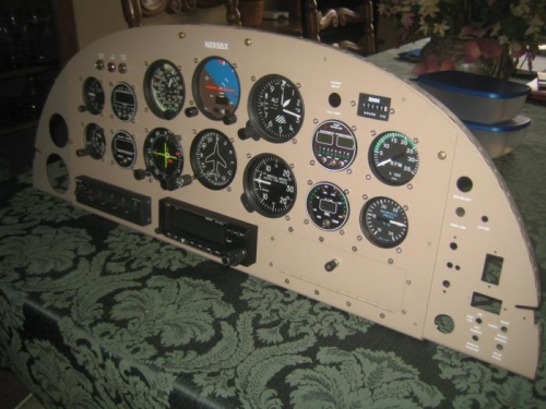

Brief Description:  Instrument panel with radios & aux panels
Here is a picture of the instrument panel with the radios mounted and the aux panels temporarily attached. The aux panel on the left will get a magnetic compass and air vent while the starboard aux will have numerous items added. These include an intercom, starter/mag switch, pitch and roll trim indicators, panel and LED dimmers, autopilot GPS selector switch, remote starter switch, rear stick enable/disable switch, map light switch, and audio input select switch (front or rear cockpit). Panel space is almost used up.
Had to the move the panel into the dining room temporarily. I am running out of shop space!
