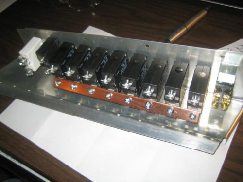

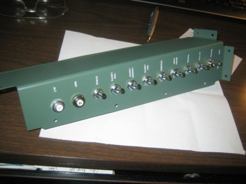

Brief Description:  Switch/circuit breaker console
I temporarily mounted the switch/circuit breakers in the console today so I could verify the drilling dimensions of the copper buss bar that ties all the breakers together and to the 12V power source. The console can be seen below from the top and from behind. I still need to tie the two std circuit breakers together and then connect them to the copper buss strip. They are not the same size so I will have to custom bend a copper strip or fabricate jumper wires out og heavy gauge wire. I also need to place a strip of insulating plastic on the inside of the console to ensure there is no arcing between the copper strip and the console.
Switch/CB Console
Switch/CB Console
Back View
Back View
