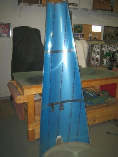

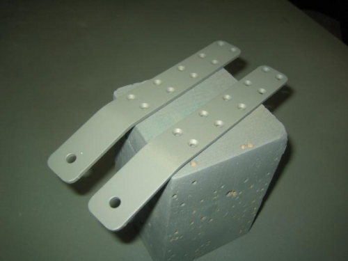

Today I did the final preparation of the aft upper fuselage skin. This included removing the protective plastic where necessary, beveling the overlapping edges, deburring rivet holes and edges, and dimpling. The shoulder harness brackets for the backseater were also match drilled, countersunk, and primed for installation.

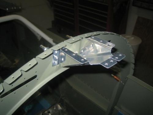

There is also a bracket that mounts on the forward edge of the aft skin and aft side of the bulkhead. The bracket was match drilled and appropriate dimpling was completed on the skin, bulkhead, and bracket.
