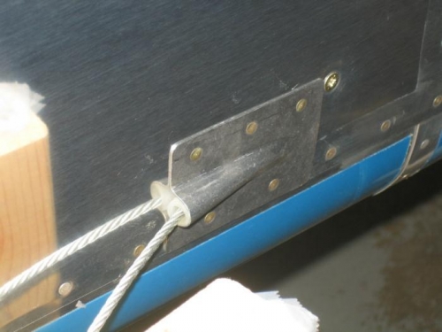

Brief Description:  Completed rudder fairings & dimpled bulkheads
I completed the rudder cable fairings and then attached the upper fuselage bulkheads with clecos. The flanges of the bulkheads were then dimpled for mating to the aft upper fuselage skin. The bulkheads and fuselage skin was mated and match drilled earlier.
Starboard Cable Fairing
