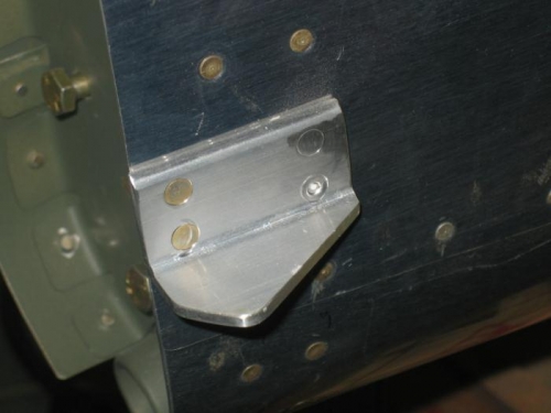

Brief Description:  Final riveting of rudder stops & cable fairings
Set the final rivets in the port and starboard rudder stops. The upper rivet was a standard solid number 4 rivet. I used a structural blind rivet for the bottom since the flush head was so close to the corner of the angle.

Rudder Stop
Rudder Stop
