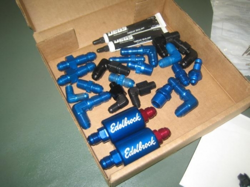

Brief Description:  Received AN fittings for fuel system
The design of my fuel system is different than Vans so I had to order some additional parts. Shown below are some of the extra items. Not all will be used but I wanted to be sure I had plenty fittings on hand to cover any forgotten requirements.
You will note the two Edelbrock high volume fuel filters that I plan to install in the wing roots providing some degree of redundancy in the event one fuel line gets clogged. Also in the photo you will see some swivel type 90 deg elbow fittings and a couple tubes of thread sealant. I Plan to use the sealant on all NPT thype threads. The normal AN tubing nuts will be torqued dry.
Various Fittings
Various Fittings
