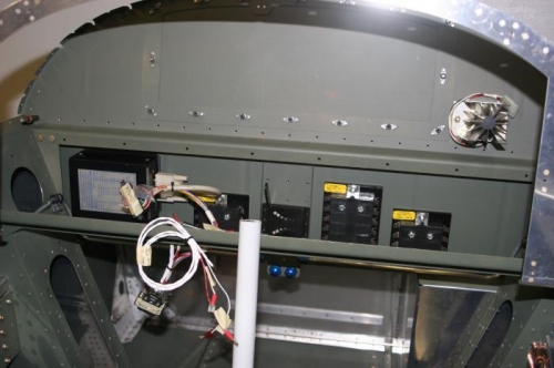

Date:  9-16-2011
Number of Hours:  4.00
Brief Description:  Mounted varioius electrical components
Today I located and mounted various electrical components including the encoder, three fuse blocks (two 8-fuse and one 12-fuse), and the heat sink for the dimmer. I tried to mount these as close to the configuration that Danny King used in the "Beautiful Doll". Since I am using his panel and wiring harnesses, any change can potentially require modification to the harnesses and I want to avoid mods as much as possible. There is a little space left for additional components if they are relatively small.
