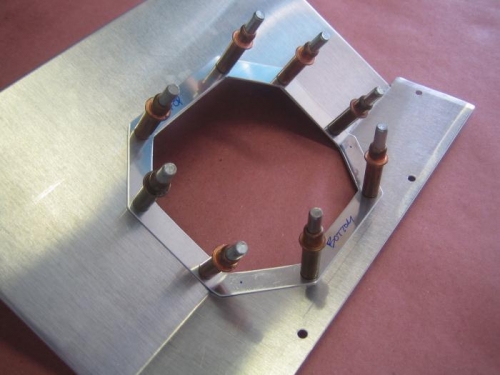

The next item was the fabrication of a ring matching the opening in the stick cover plate. The ring was cut from some fairly heavy aluminum and match drilled to the cover plate. Connie will be making a boot using some heavy khaki canvas that will be fastened under this ring. The plan is to wrap the boot material around the ring which will be mounted and screwed down on the outer surface of the cover as you see here. I need to order some number 6 platenuts to be riveted onto the ring. The screws will be inserted from the under side of the cover. Hope this description is clear.

Stick Cover
Stick Cover
