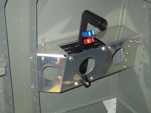

Assembling the front quadrant wasn't too difficult but did require a little fitting. One of the nutplates already installed interfered with the new throttle fitting snugly to the aluminum housing. The Dremel tool with a little grinding wheel fixed the problem quickly.
The only other issue with the front assembly was a required spacer, again to make the deluxe quadrant fit flush within its aluminum housing.

Front Cockpit Quadrant
