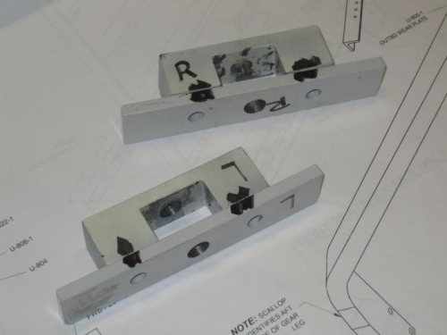

I spent just a little time in the shop this afternoon completing some minor riveting that I somehow missed when finishing the mid-cabin fuselage skins (cockpit rails to upper longeron). This took just a few minutes so I then began the landing gear installation.

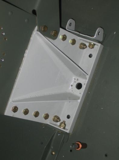

First, the 7/16" and 1/4" holes in the WD-813 weldments were final drilled to remove any powder coating and correct misalignment with holes in the F-822 fwd floor panel. The gear legs were mated to the U-804 inboard main gear attach brackets and the U-804 brackets were match drilled to the gear legs (7/16" hole). The U-804 brackets were removed and marked left and right. Finally, the inboard wear plates (U-806) were match drilled to the U-804 brackets (the 7/16" hole).

Final Drilling of WD-813
Match Drilling U-804
