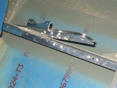

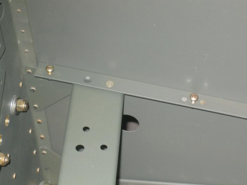

In the interim, I installed a few nutplates that were skipped earlier (those on the auxiliary longerons for the cabin covers and the four on the floor ribs for the rear control mounting bracket). The rear most nutplate on the right auxiliary longeron was a problem. For some reason the matched hole on this angle was located as to create an edge distance issue with the nutplate's attach rivet. Anyway, I had to order a special nutplate with a single mounting lug. Actually, I ordered a few single lug platenuts and a few that were described as "corner" nutplates. Not sure what the difference is but they have different MS numbers.
By the way, I couldn't get a squeezer or rivet gun on the longeron nutplates so I modified a pair of larger Vise-Grips per Van's suggestion to set the number 3 rivets. I ground the jaws on the tool to create two flat surfaces for squeezing the flush rivets. It works but it takes considerable hand strength to set the rivets. Oh, if you try this be sure to wear gloves and don't get any meat on your thumb or fingers pinched as the Vise-Grips lock up. IT REALLY SMARTS!
Platenuts in Auxiliary Longeron
Platenuts for Control Mount

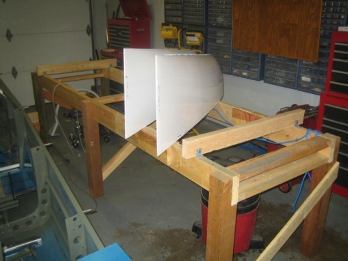

Shortened Jig
Shortened Jig
