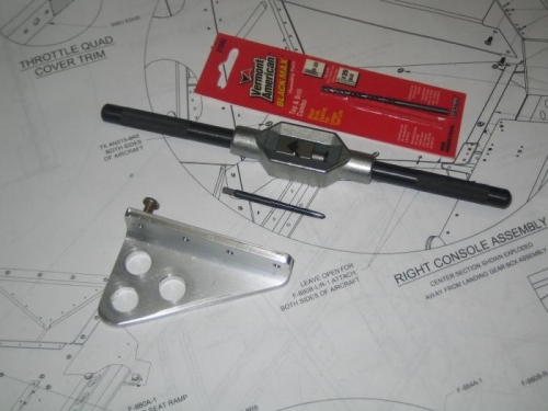

I worked at the museum today but did get a couple hours in the shop later in the evening. I decided to go ahead and fabricate the cable anchor per the drawing even though the drilled holes are not exactly as they appear in the landing gear box bulkheads (close but not exact). I may call Van's tomorrow just to double check.

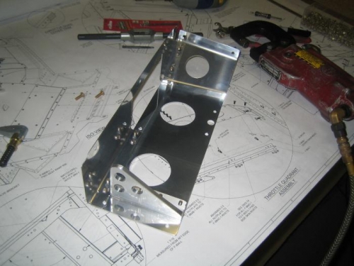

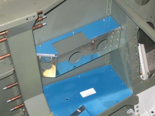

In any event, the anchor was made quickly using a wood cutting band saw, vixen files, a unibit, and a scotchbrite wheel. The bracket was then match drilled to the quadrant and the four mounting holes were tapped to 8-32 for screws. The bracket and the two parts of the throttle quadrant were then assembled and installed temporarily in the fuselage. It all went together nicely.

Cable Anchor Bracket
Bracket & Quadrant
Bracket & Quadrant
Quadrant Installed
Quadrant Installed
