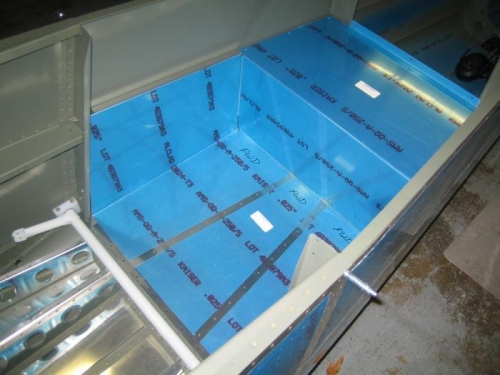

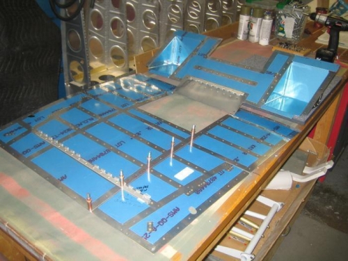

1) The cockpit floor panels were completed including the foot wells and seat hinges.
2) The nutplates were installed on the rear baggage compartment panel.
3) The seat ramp assemblies for the front were completed.

Front & Rear Floor Panels

Rear Baggage Compartment
