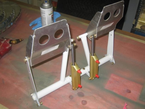

Manual Reference:  DWG OP-3 & 8-37
Brief Description:  Initial assembly of rudder pedal components
I match drilled the brake cylinder bracket to the rudder axles and then did the initial assembly of the rudder pedal components. The OP-3 drawing is very hard to read so I am not sure the various bolts, washers, and nuts are just right. I believe a couple thin washers should be added on a couple of the bolts as thrust washers. I also think a couple thin nylon washers should be added to the brake cylinder bracket where the cylinder attaches. Hopefully, the local hardware will have some nylon washers that will work.
I also noted that two of the bolts are not long enough to allow the slotted nut to seat properly with the called out washer. I may have to order longer bolts or make some other adjustment.

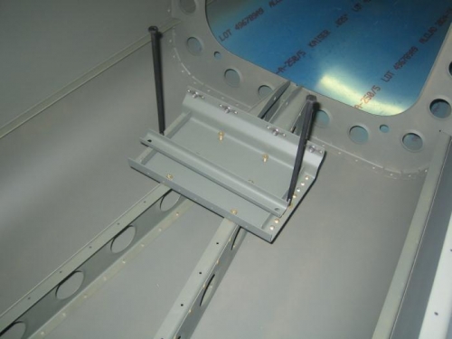

To wrap up the day, the battery tray fabricated earlier was set in position and the screws finger tightened.
Rudder Pedals
Rudder Pedals
Battery Tray
Battery Tray
