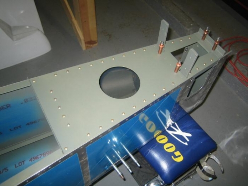

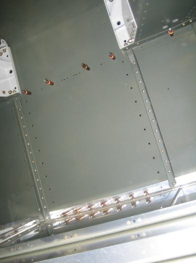

Brief Description:  Installed rudder angles & riveted rear deck
I began the day by removing the rudder mounting angles and getting them deburred and primed. After the primer dried they were clecoed in place and Connie helped me get them riveted. I then set the rivets on the rear deck except for the ones that are common with the elevator stop brackets. These were skipped so the brackets can be trimmed later when the elevator is fitted.
