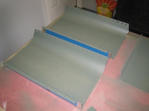

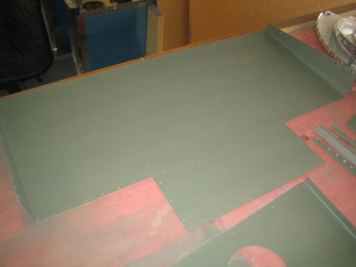

Brief Description:  Finished preparation of forward bottom skins
The forward bottom skins for the fuselage were completed today. The skins had previously been clecoed in place so it was just a matter of match drilling, removal, deburring, and dimpling all the required holes. The skins will be ready to install as soon as the landing gear are positioned and match drilled to the fuselage.

Fwd Bottom Sides
Fwd Bottom Sides
Fwd Bottom Center
Fwd Bottom Center
