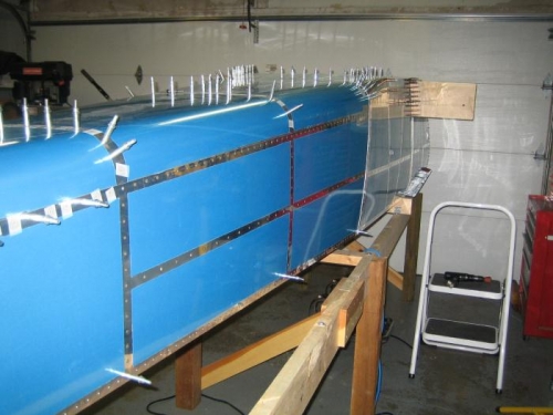

Starboard Side
Starboard Side

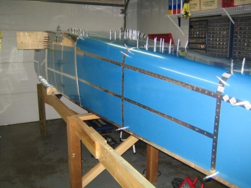

Port Side
Port Side

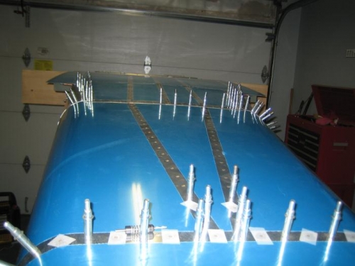

Bottom Side
Bottom Side
