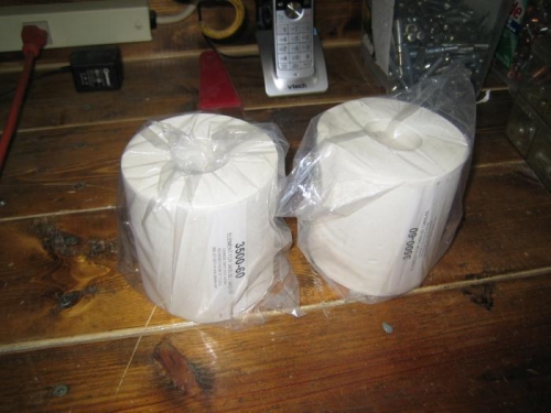

The first image below shows the elements that are the heart of the coalescing filter. These elements are removed when saturated and set in the sun to dry. They can then be reused. The kit comes with a spare element but I ordered a second spare to be sure I always have a useable filter while one is drying (it can take a couple days for an element to fully dry out).

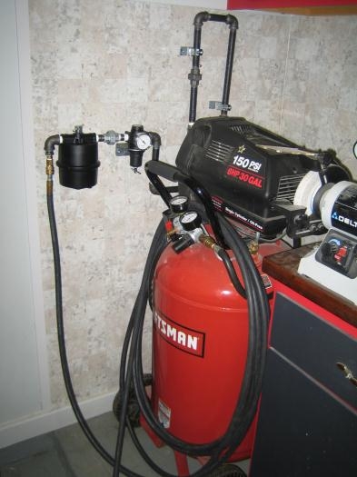

Well, the new piping and filter kit is installed, the compressor drained, and everything is good to go.
Coalescing Filter Elements
All Hooked Up
All Hooked Up
