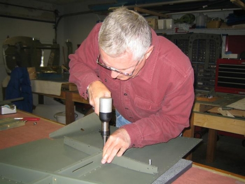

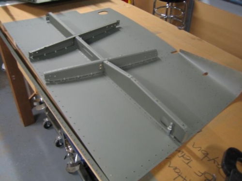

Brief Description:  Attach arm rest assembly to mid skins

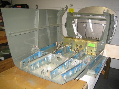

After finishing the initial work for the rear throttle, the left and right arm rest assemblies were riveted together and then clecoed to the mid skins. All the arm rest assembly components were then back riveted to the skins with the exception of the rear-most arm rests. After installing the required nutplates on the left and right outboard seat rib angles, they were clecoed in place with the left mid skin.
In the next shop session the starboard mid skin will be installed with both upper longerons. Then the forward skins will be prepared and installed. The structure is going to look like an airplane very soon.
Back Riveting Mid Skins
Riveting Complete
Riveting Complete
Mid Skin Clecoed to Fuselage
