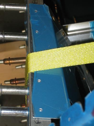

Brief Description:  Positioned LG boxes to upper longerons
Per the shop instructions, I used a cargo strap with winch to snug the top of the landing gear box assemblies to the upper longerons. The webs are not completely flush with the longeron vertexes but are close. There will be plenty of edge clearance in the longerons when match drilled. I plan to loosen the strap slightly before drilling to ensure minimal tension on the airfame structure.
Right Side
Right Side
Left Side
Left Side
