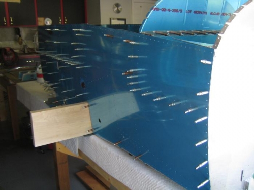

Brief Description:  Attached skin to right side forward fuselage
I had just enough 1/8" clecos to position and attach the right side skin to the forward fuselage assembly. The left and right angles were clecoed in place to support the throttle quadrant and the switch/circuit breaker console.
I will need to order an additional 200-300 1/8" clecos before proceeding much further on the fuselage. Hopefully, I can find some tasks that can be accomplished while waiting for my next order (there is always something to do). In any event, I want the structure very stable, straight, and surfaces flush before match drilling the fuselage. That will require a liberal use of clecos.
