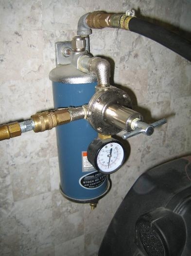

Speaking of Harbor Freight, my next task was to repair my filter/regulator for the second time. A few months ago, the internal diaphram corroded and became stuck rendering the regulator inop. This time the adjuster mechanism (large T-shaped screw) became stuck. when disassembled I found that one of the threads was galled making it extremely hard to adjust. I cleaned up the threads with a tap and file/wire brush, lubed the screw and diaphram, and reassembled. Regulator is working again but who knows for how long. I wouldn't recommend this Harbor Freight product. I don't think it effectively filters anything though it does provide regulation when it works.

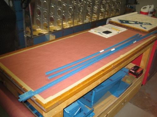

The last maintenance task for the day was a general cleaning of the space, recovering the workbench with some fresh protective paper, and pulling the parts for the tail cone.
Harbor Freight Filter/Reg
Ready to Begin Tail Cone
