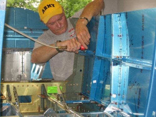

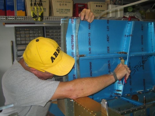

Brief Description:  Continue mid-fuselage skins & structure
Once the mid-fuselage skins were clecoed in place the arm rest components including bulkheads were added to both the left and right sides. These components were then matched drilled to each other but not to the skins. The F-805G gussets and the left and right F-805B floor support angles were also positioned and match drilled.
Arm Rest Parts
Arm Rest Parts
Initial Assembly
Initial Assembly
Match Drilling 1/8
Match Drilling 1/8" Holes
