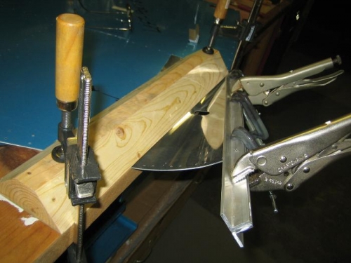

The next task was to fabricate some simple wood blocks and an aluminum angle tool to make the roll at the bottom aft end of the mid-fuselage skins. The table saw for the wood and the bandsaw for the metal pieces made short work of this task. I bent the left skin and it looks good but I won't know for sure until it is fitted to the fuselage (may have to come back and bend a little more later). I will have to modify the fixture before bending the right skin which must be a mirror of the left side. It shouldn't take more than 10-15 minutes to change the fixture and I will be ready to roll the starboard side.
Rolling Skin
Rolling Skin
