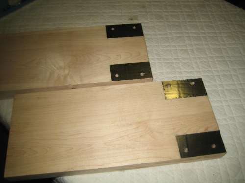

Brief Description:  Completed spar spacers & torqued bolts
The stainless tape for my spar spacers arrived today. After reconfirming the measurements of my wing spar and the maple spacers, I applied layers of metal tape to the spacers to ensure they were a few thousandths thicker than the wing spar bars.

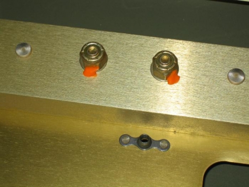

In preparation for assembly the center section box, the bolts were torqued and marked with some Torque Seal.
Spar Spacers
Spar Spacers
Torqued and Sealed
Torqued and Sealed
