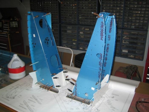

Brief Description:  Begin landing gear box assembly
All the parts for the initial assembly of the landing gear boxes were pulled. The bandsaw was used to separate the left and right F-802H and F-802G angles. These parts are made from heavy angle requiring more than regular snips. The tabs were also removed from the F-802-C-1 left and right box webs. All the parts were then deburred using a scotchbrite wheel.
The left and right landing gear boxes were clecoed together including the weldments in preparartion for match drilling.
Landing Gear Boxes
Landing Gear Boxes
