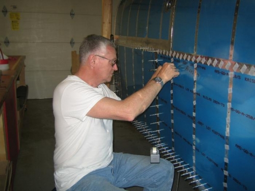

Date:  4-6-2010
Number of Hours:  3.00
Brief Description:  Begin riveting top skins

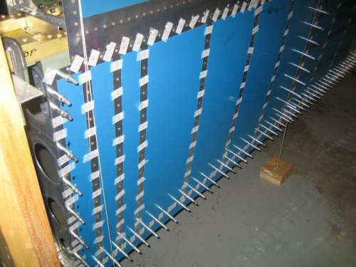

I removed every other rivet, dressed the dimple with a deburring tool, and inserted/taped the appropriate rivet in place in preparation for riveting. After setting all the rivets with Connie's help, I removed the remaining clecos and inserted the rivets using the same procedure previously described. I plan to complete the riveting tomorrow morning.
Inserting the Rivets

Ready to Rivet
Ready to Rivet
