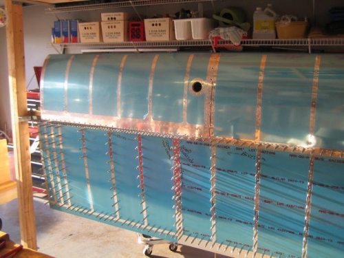

Date:  3-31-2010
Number of Hours:  4.00
Brief Description:  Fitting of tank and top skins
First task today was to remove the plastic from the outboard skin and then deburr and dimple both skins. The wing walk doubler was also deburred and dimpled and the scarfing of the two top skins was accomplished. The scarfed edges were then coated with self-etching primer. The tank assembly was installed temporarily and the top skins fitted in preparation for riveting.
Tank & Top Skins
Tank & Top Skins
Different Angle
