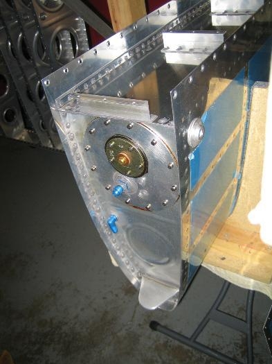

Brief Description:  Finished starboard tank
The starboard fuel tank was completed today by sealing all the spanwise rivet heads attaching the skin to the rear baffle and installing the root rib access plate and fuel sender. The tank was then set aside to cure in preparation for the leak test. The leak test will include both a thorough soap bubble exercise and observation and measurement of an inflated balloon (attached to the vent line) over a period of days. I used these same methods on the port tank to check its integrity.

Tank Completed
Tank Completed
