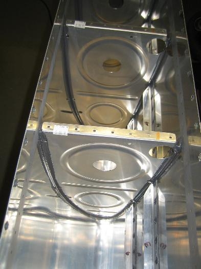

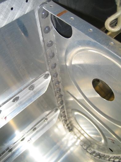

The shop session today was very tedious. I began the day by mixing and thinning a batch of tank sealant to create fillets along each internal rib. The fillets for the two end ribs had already been completed in an earlier session. I appllied the sealnt with a syringe and then finished it with a popsicle stick. After completing the fillets, the remainder of the day was spent sealing each rivet shop head.
Rib Fillets
Rib Fillets
Tank Rivet Shop Heads

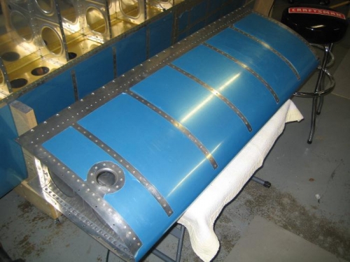

Tank Without Baffle
Tank Without Baffle
