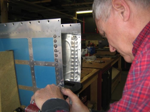

The end ribs on the tank have been curing for a couple days so it was time to wet set the rivets. My procedure is to remove every other cleco, remove any partially cured sealant left behind in the rivet hole, dress the dimple lightly with a deburring tool, put a dab of sealant in the dimple, insert the rivet, and squeeze. I then clean off the sealant and inspect the rivet head.
The riveting went well, however, upon close inspection after wiping away the excess sealant I found five rivets, each with a tiny crack in the manufactured head. I still don't know for sure why this happens but I suspect it is from over squeezing or over driving. Upon close inspection of these bad rivets, it looks like they may have been located where there was a little pillowing of the rib flange and sealant. Perhaps the "thicker" material put more pressure on the rivet as it was squeezed? Anyway, I drilled out the bad rivets and replaced with some "oops" rivets. I probably could have used the standard rivets but the special rivets gave a little better result.
