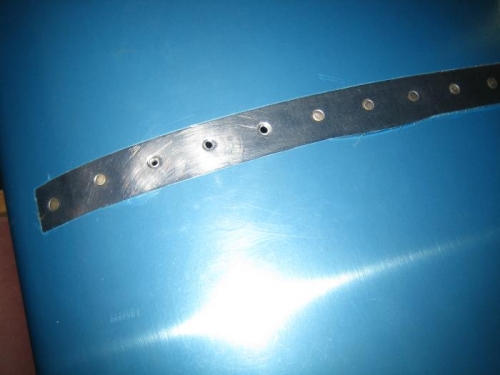

This evening I was inspecting all the manufactured heads on the driven tank rivets and found four rivets that had tiny cracks in the flush head. If you look closely in image one below you can see a tiny triangular crack in each rivet head. Oddly enough, all four rivets were in the same tank rib close to the leading edge (three on the top surface and one on the lower surface). I debated whether to replace these rivets but in the end decided to drill them out and replace. While I don't think they would leak or present a structural issue, they will certainly be easier to correct now than later. I am not sure why these rivets cracked. They did not appear to be over-driven and both the shop and manufactured heads looked ok. Nevertheless, they did crack.

Notice the Cracked Heads
Rivets Drilled Out
Rivets Drilled Out
