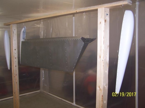

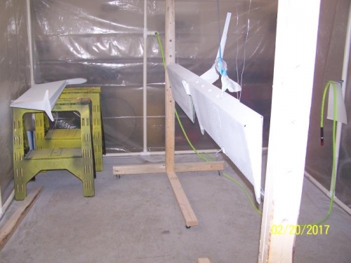

Prepared rudder and elevator for priming. Using Stewart Aystems products. Cleaned with EkoClean then used EkoEtch followed by powewashing. Blew dry then let dry in booth for 4 hours.
Primed with EkoPrime. Like using this waterborn paint.
