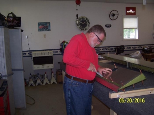

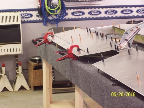

Trimmed piano hinge to fit, Drilled and clecoed hinge into place. Placed trim tab skin onto hinge and drilled, clecoed into place. Cut servo rod to length, mounted clevis' onto rod and placed servo into elevator. Checked up and down angles. Added stiffener to side of servo. Drilled 4 holes on elevator skin for servo wire keepers.
