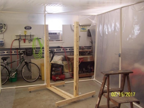

Brief Description:  Readied paint booth
Constructed paint booth with PVC pipe and plastic sheeting. Made wooden door frame and put 4 furnace filters in body of doorfor filtered intake air. Exhaust with box fan in rear of booth with filters on front and back of fan. Made rotors out of 2X4's and casters.
