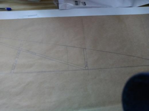

After assembling and leveling the work bench I laid out the pattern for the Rib Jig.
I divided the paper in half marked out the rib stations and began to mark the outline of the rib IAW Plan Sheet 5.
I will finish this tomorrow, given the double measurement of the rib outline (the first from the datum to the lower edge and then from the lower edge to the upper edge of the rib, I will mark the lower edge of the template and then the upper edge once I have the lower form marked. Hopefully this will be less of a headache.
