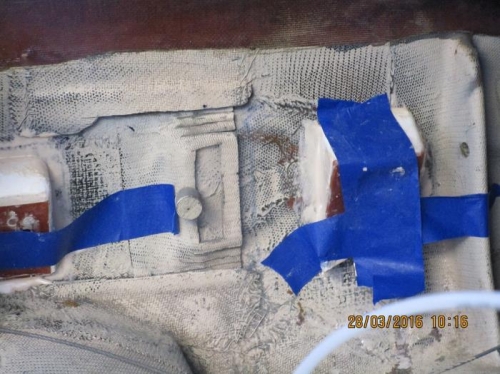

Manual Reference:  Pg 3-5
Brief Description:  Fixing Mstr Brake Cly mounts in place
IAW page 3-5 of the builders manual I fitted the brake master cylinder mounts and the brake handle locknut mount to the left side of the forward fuselage (Mstr Cyl mounts) and in the left console (Brake handle mounts). Figure 2 does show the fwd mounts leaning forward, the angle is approximately 10 degrees as this will help[ with replenising brake fluid.
The mount for the brake handle (fig 3) I decided to remove the foam from the lower half so that I could flox the mount in place but leaving the foam on the top half so that I could use it to dry micro the mount and have it act as a spacer for the mount. The fitting of the mount was IAW page 3-5 of the builders manual the same method as fitting the master cylinder mounts.
I will need to lay 2 BID of glass over the master cylinder mounts to ensure they do not move. I will try to do the same for the brake handle mount but it is very confined hance my reasoning for using flox.
Mstr Cyl Mounts foam coated in slurry
Fwd Mstr Cyl Mount
Fwd Mstr Cyl Mount
Brake handle mount foam cleaned on lower half to allow for floxing
