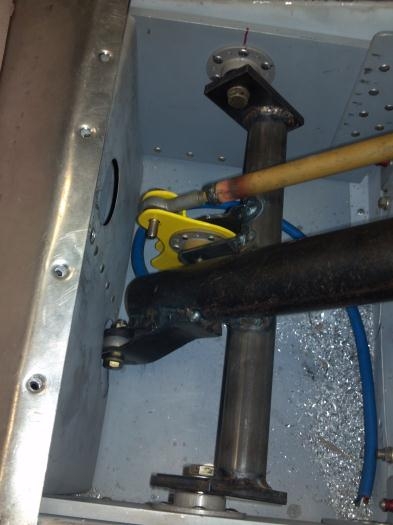

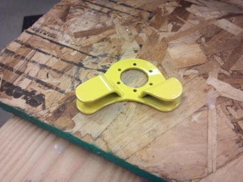

Brief Description:  Aileron control stick bellcrank
Tim was over and we worked on the front seat stick aileron bellcrank. We ran into a little problem with the travel to the right. I need to notch out some of the bellcrank support mount in order to allow some more travel. This is a unique setup compared to any of the RV's. I wanted to accomplish aileron movement with out banging the stick into my thighs. The aileron movement from the stick is now located at the top of the stick and the only movement of the lower stick assembly is fore and aft.
