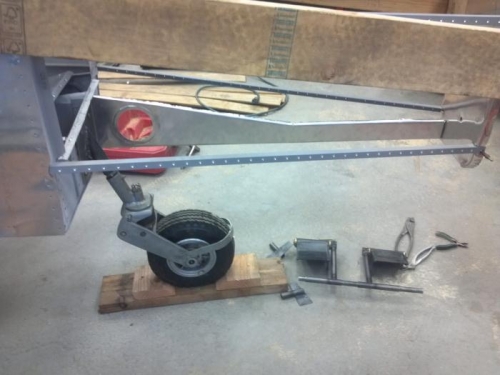

Nose stripped down
Nose stripped down

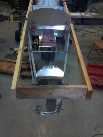

New nose jig
New nose jig

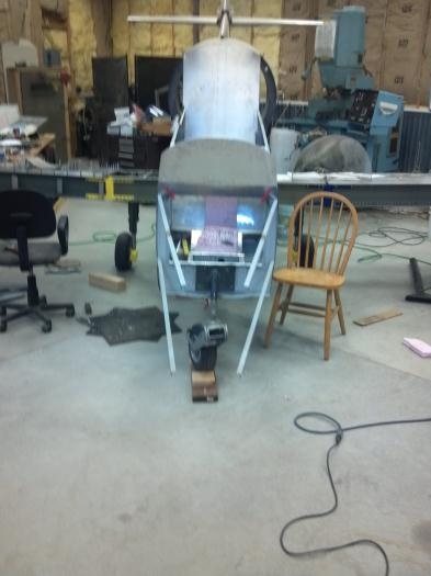

FWD fuse lower former.
