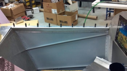

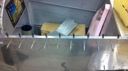

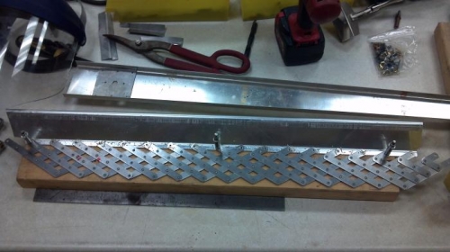

Cockpit edge stiffner & canopy seal area
I bent up some .061 aluminum in a modified "z" shape to strengthen the edge of the cockpits. It will also serve as a wire run later for wiring that needs to go to the rest of the fuselage.
