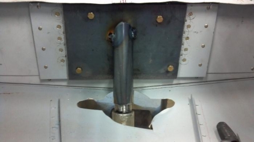

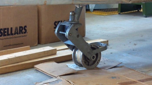

Brief Description:  Nose gear install
Purchased this nose gear from Oshkosh this year. Tag said it was originally from a lanciar 235 kit. It was exactly what we were thinking of...a full castering trailing link nose gear. I will need to "loosen" it up a little though. The donut which squishes during the shock absorbtion process is much too stiff for the hurricane. I am thinking of removing portions of the rubber donut until I get better travel and a little less stiffness.
