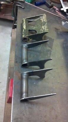

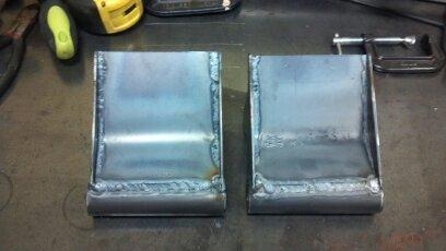

Date:  10-19-2011
Number of Hours:  3.00
Brief Description:  Rudder pedal fabrication
I purchased some overhead rudder pedals @ oshkosh this year only to find out that the angle they hang at makes them too wide to fit in the fuselage. I decided to fabricate an entirely new assembly based on the design that I purchased from oshkosh. The purchased pedal assemblies are adjustable to three positions. I plan on extending the adjustable portion to 5 or 6 positions. (my wife is short) The next step will be to fabricate bushings that the pedals pivot on.
