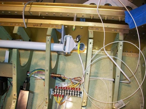

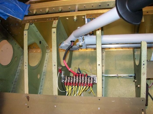

Today I got the wiring done for the sticks. I made the co-pilot stick removeable with the addition of a DB-9 that connects the wires from the grip to the harness that I made that connects to the terminal strip under the pilots seat pan. Since the switches can all be parralled except the PTT, that seemed to be the best solution. In the last picture you can see where I installed the Safety Trim control box. I lets me get by without all the relays for the trim and gives me a way to stop or reverse the trim in case of a runaway trim.
Co-pilot Side Removeable
Pilot Side
Pilot Side
